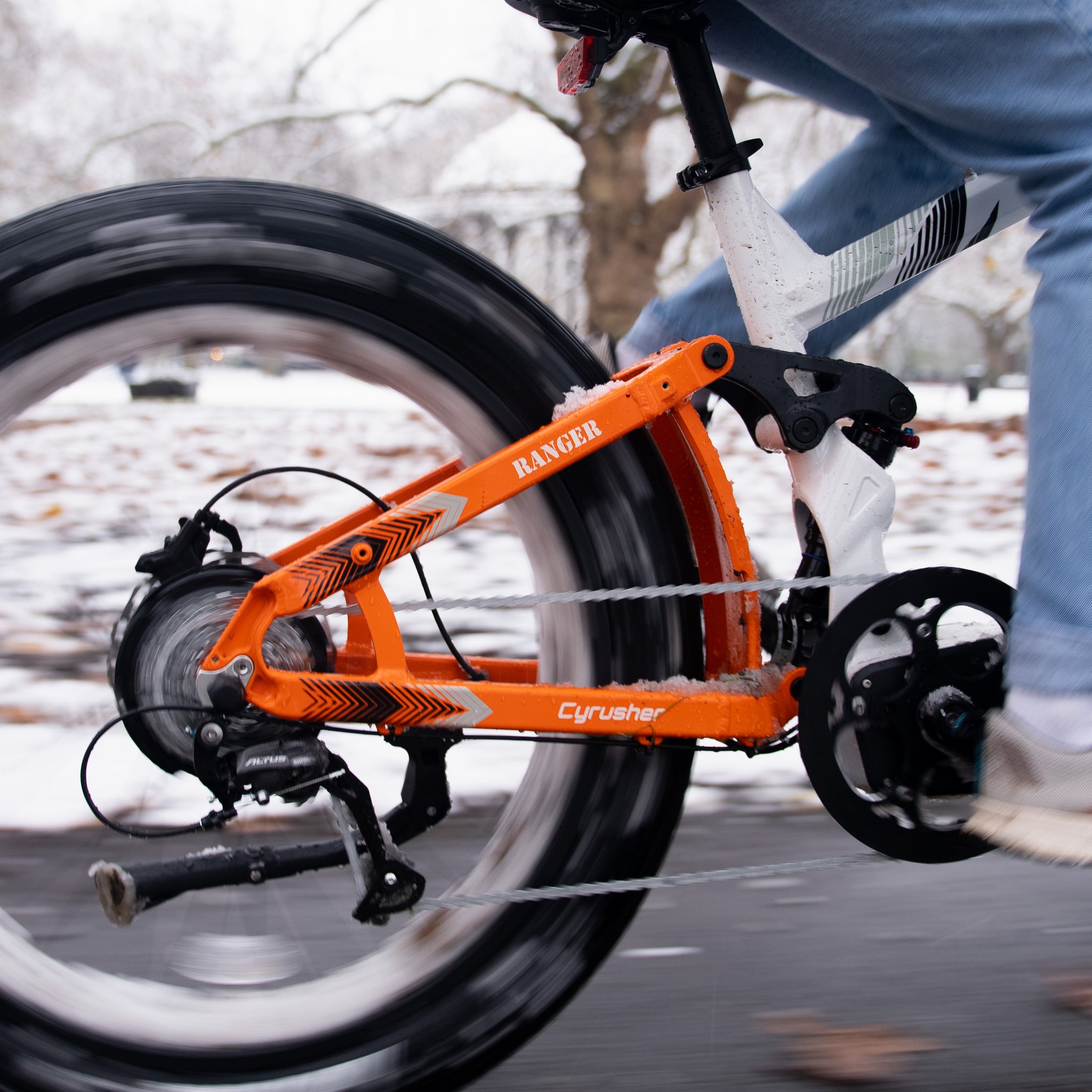

Blog-Cyrusher rear hub motor ebike

Rear hub motors
Because the rear hub motor does not rely on a chain drive, you can easily ride it home even if the chain breaks. Additionally, there is no excessive wear and strain on the chain and gears. However, a hub motor will not power your ride as effectively as a mid-mounted motor so if you want greater climbing capabilities, you will need a larger motor and battery which will also increase the weight of the vehicle. The addition of the motor to the back wheels results in a more rear-facing centre of gravity for the entire model and the overall operating balance of the vehicle is not as excellent as with a mid-drive motor.
Furthermore, replacing the tires can be time-consuming due to the large number of components located on the rear wheel and the necessity to avoid several wires in order to remove the tires. Most e-bikes on the market feature the more cost-effective rear hub motor, which offers great value in an e-bike and does not suffer from significant power loss.

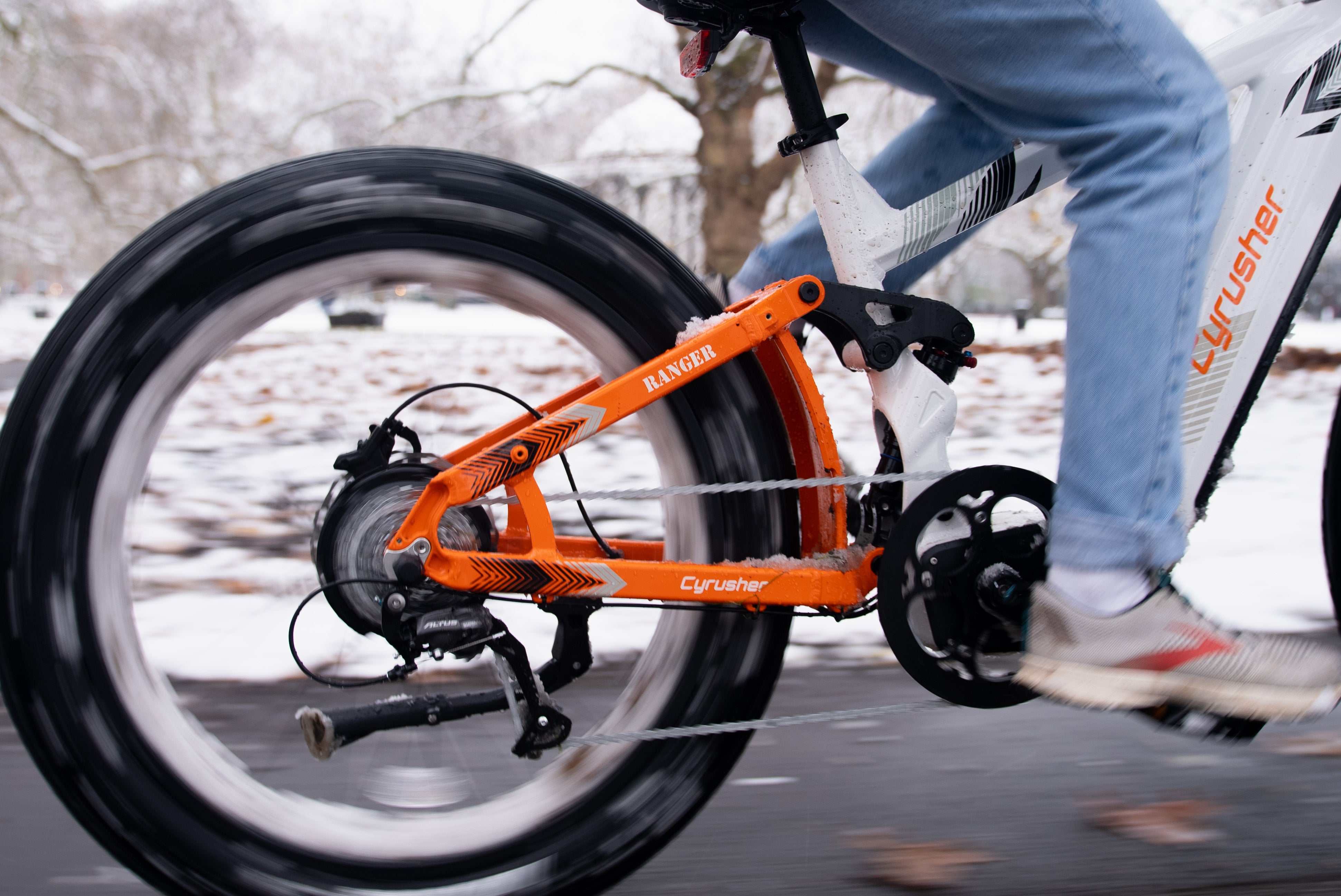

Blog-750W motor electric bike RangerWhen purchasing, one of the most common problems is how to choose the motor power. Different power levels imply different running capabilities. The type of bike you choose depends on your weight, desired speed and whether you plan to ride on off-road terrain.

The battery voltage and controller amperage can be analyzed to better estimate vehicle power. The Cyrusher Ranger uses a high-quality 750W Bafang motor which provides a more robust output. Typically, the Bafang motor can meet complex mountain riding needs with an efficiency of 75%. Ranger chose a 52V 20AH battery pack; therefore, the calculation result is 52V * 20AH = 1040W. The efficiency loss after calculation predicts that the vehicle will reach 780W of power, providing you with an impressive riding experience.
