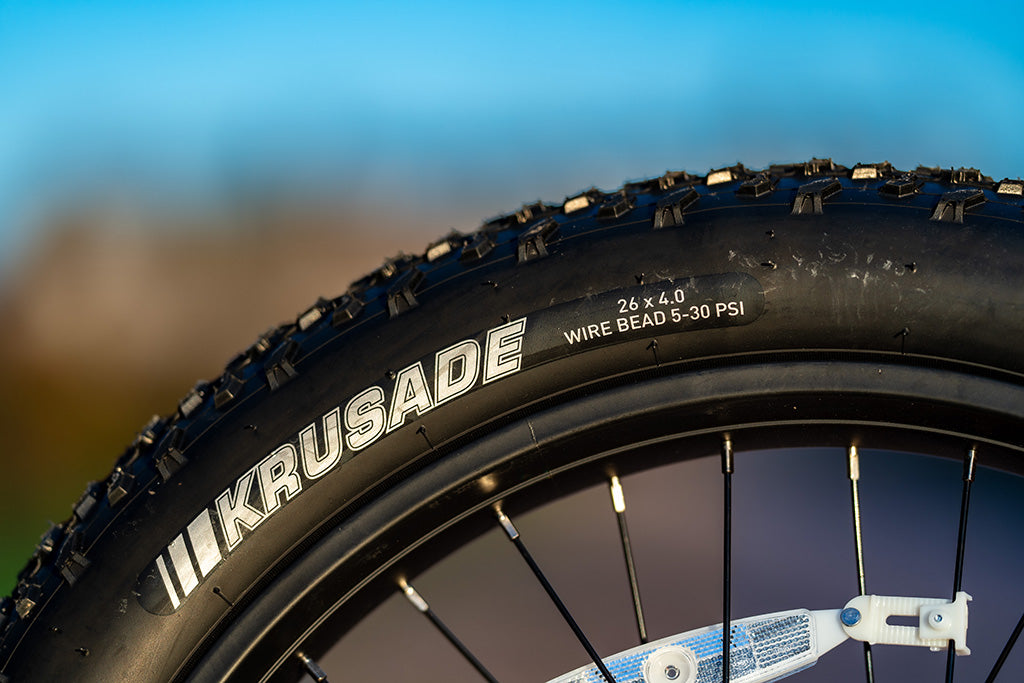

  1. Choosing puncture-resistant fat tires
Choosing puncture-resistant tires can help decrease the likelihood of getting a flat tire. Cyrusher electric bicycles are equipped with puncture-resistant fat tires that all have inner tubes. If the inner tube gets damaged, it can be easily replaced, allowing the bicycle to be back in action promptly. Fat tires are effective in absorbing the impact from obstacles on the road, thereby lowering the risk of tire blowouts.
