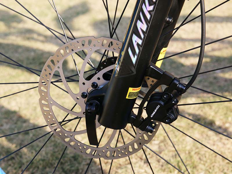

The e-bike braking system is quite similar to that of a traditional bicycle. However, e-bikes commonly use a disc brake system. When you squeeze the brake handle, the hydraulic system applies pressure to the caliper. The caliper then presses the brake pads against the wheel, causing the brake pads to squeeze the rotor. This creates a friction force between the pads and the discs, gradually slowing down the wheels. As the wheels slow down, a portion of the energy is converted into heat which dissipates. This allows the rider to control the speed of the bicycle and bring it to a complete stop.

Electric bikes commonly utilize two types of brake systems: mechanical disc brakes and hydraulic disc brakes. These two braking systems operate on different principles. Mechanical disc brakes employ a metal tube to engage the brake pads and activate the brakes. On the other hand, hydraulic disc brakes rely on the use of pressurized braking fluid to compress the caliper's pistons and apply force to the rotor, effectively reducing its speed. Hydraulic disc brakes utilize hydraulic pressure to power the pistons. In contrast, mechanical disc brakes rely on the friction between a pad and a rotating drum connected to one or two calipers.
