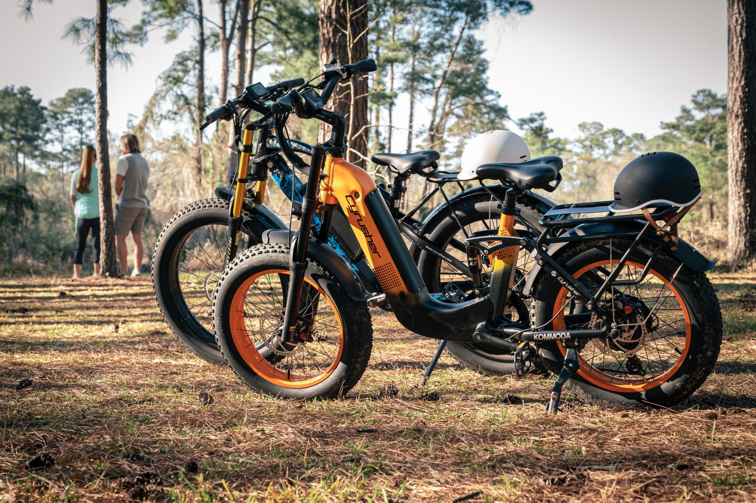

For example, Cyrusher Kommoda uses a 750W brushless motor with a maximum peak value of 1000W. Its powerful motor operates at high speeds, combined with a 5-level pedal assist mode for easy cruising. It also has a 48V, 14AH lithium-ion battery that can travel 20-50 miles on a full charge. The battery has enough capacity for your adventures and is removable, allowing it to be removed and charged while charging. Its step-by-step construction also considers shorter riders and those with limited mobility. Its other high-quality components allow urban commuting and a variety of rough terrain without restrictions, giving the rider an incredible experience.
