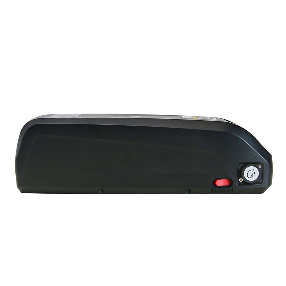

624Wh
48V 13Ah Battery

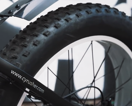

Fat-Tire Footprint 26×4.0
Chaoyang fat tires give XF900 PRO its broad, planted footprint and unmistakable stance.

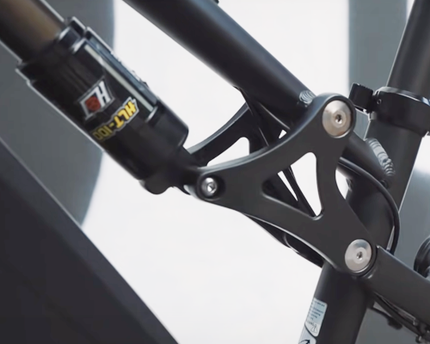

03 · Oil-Spring Rear Shock
Take the edge off
Oil-Spring Rear Suspension
A straightforward oil-spring rear shock supports the full-suspension chassis and helps soften impacts from rougher surfaces.
WHY IT MATTERS
Rear compliance helps reduce the sharpness of broken pavement, gravel and repeated bumps without pretending the bike is a downhill machine.Hardware: oil-spring rear shock, 210 mm / 32 mm.

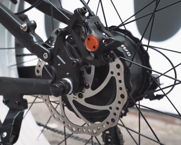

04 · Hydraulic Brakes
Controlled braking
Hydraulic Disc Brakes
Hydraulic actuation gives progressive lever control, with motor cut-off when the brakes are applied.
WHY IT MATTERS
More predictable lever feel matters when a full-size fat-tire bike carries speed, especially on descents and changing road surfaces.Hardware: HD-E500 hydraulic brakes, 180 mm rotors, 2.3 mm thickness.

26 × 4.0 Chaoyang Fat Tires
Wide skinwall tires give XF900 PRO its substantial contact patch and recognizable full-size stance.
WHY IT MATTERS
The broad footprint complements the suspension with added stability on loose, uneven and imperfect surfaces.Hardware: Chaoyang 26 × 4.0 skinwall tires, 30 TPI.

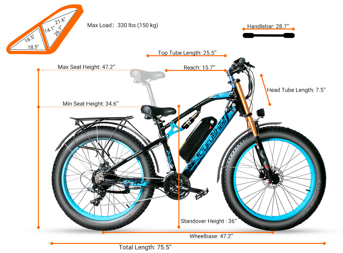

Saddle to Handlebar
Standover Height
Min Saddle Height
Max Saddle Height
Handlebar Height
26.6''/67.6cm
29.13''/74cm
48.82''/124cm
34.84''/88.5cm
44.29''/112.5cm
77.56''/197cm
43.9''/111.5cm
5.6ft ~ 6.6ft (170cm ~ 200cm);

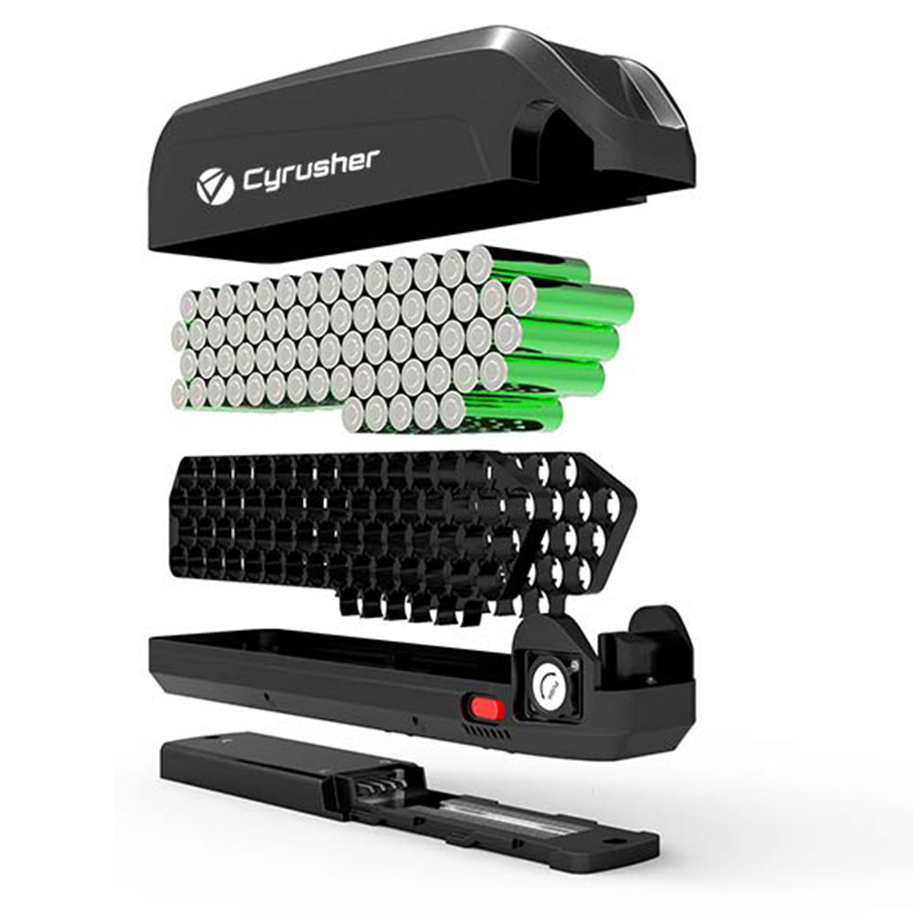

48V 13Ah, 18650 Cells
Charger
48V 2.0A
Battery Charge Time
7-8 hours
Battery Lifetime
800 cycles
Speed Class
Class 2/3
Weight with Battery
71.2 lbs (32.3 kg)
Battery Weight
8.4 lbs (3.8 kg)

Tires
Chaoyang 26" x 4.0"

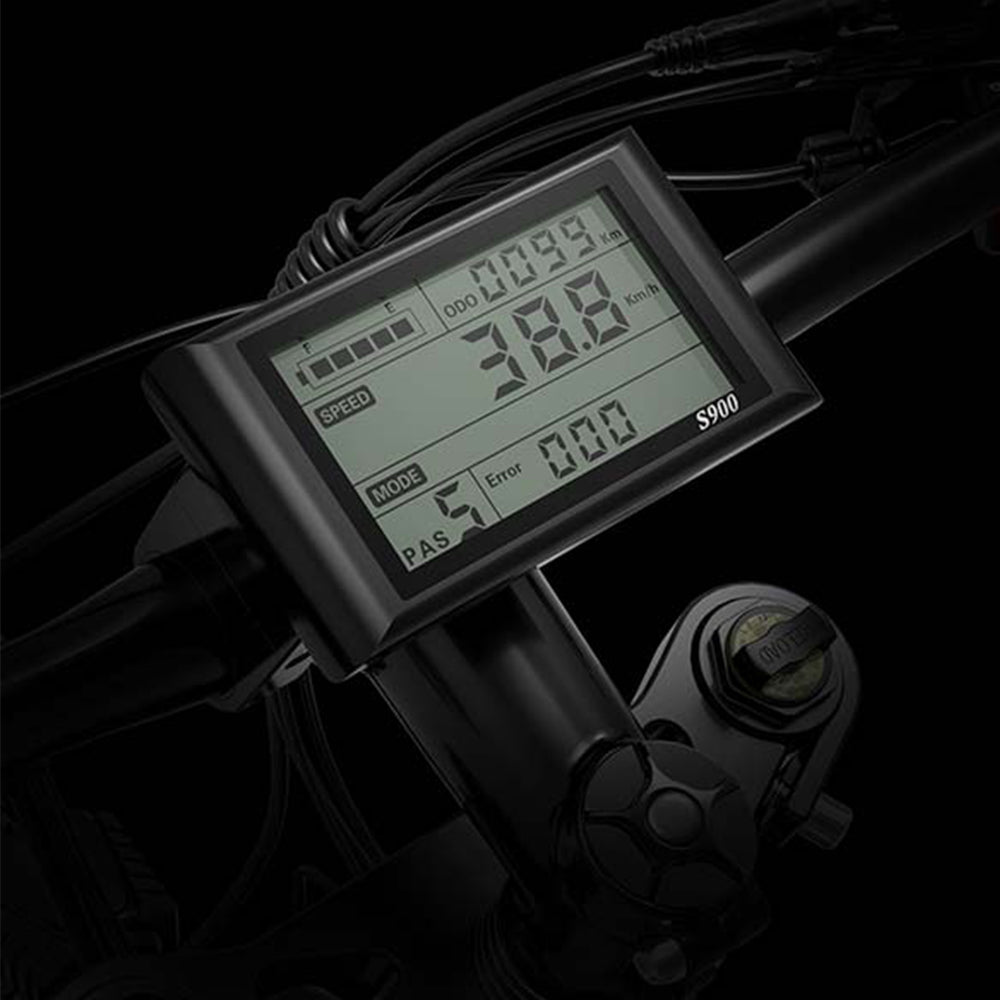

Display
K5351-L5-2 Smart Display with Turn Signal Indicators

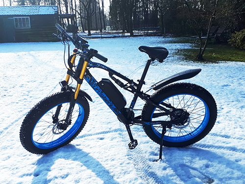

Couple of pics on my ride over the weekend, 250+miles so far and still going strong..

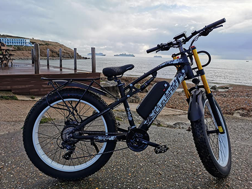

Just a wee run down around Dysart this morning, a bit nippy outside

Greg Hovorka
How much does it weigh?
Cyrusher E-bike
Bike Weight is 75 lbs (34 kg) with battery
G
Greg Hovorka
How much does the 900 weight?
Cyrusher E-bike
