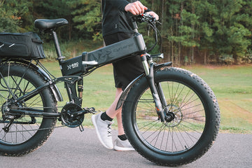

The correct tire pressure has always been one of the most controversial topics, but the minimum and maximum tire pressure ranges are printed on the sidewall of most tires. For example, the Cyrusher has an upper limit on tire pressure marked on the side of the tire: max inflate to 20 PSI 140 kPa 1.4 BAR. It is recommended not to exceed this limit, as the manufacturer specifies it for a reason. Although more than a point and it will not explode immediately, it is best not to do so.
the fat tires for cyrusher xf690
